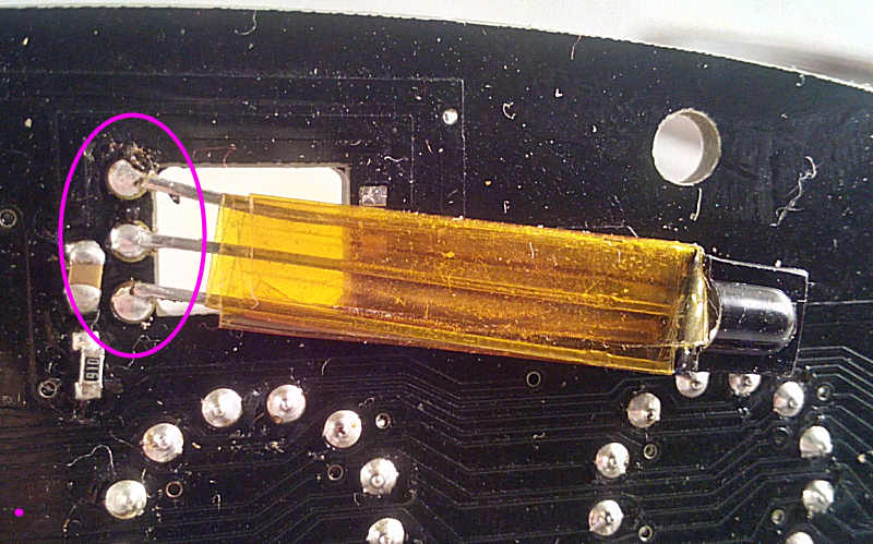

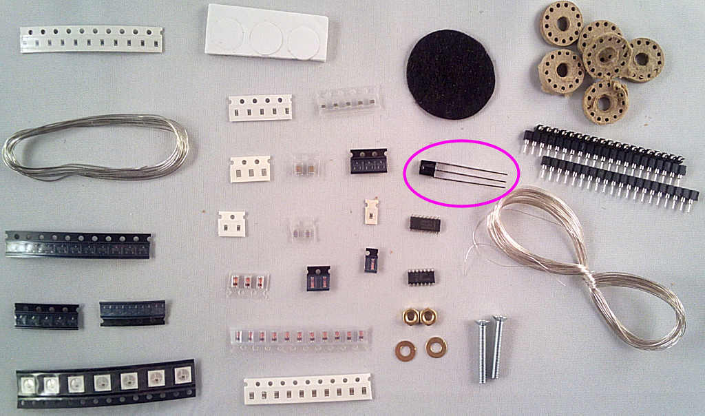

Wrap the legs of the 3-legged IR receiver in insulation tape to prevent them shorting against anything on the PCB and solder it to these 3 pads with the domed side of the sensor facing up. This puts it in a better position for IR reception than the original PCB cutout, needed due to a design change on the base lid.

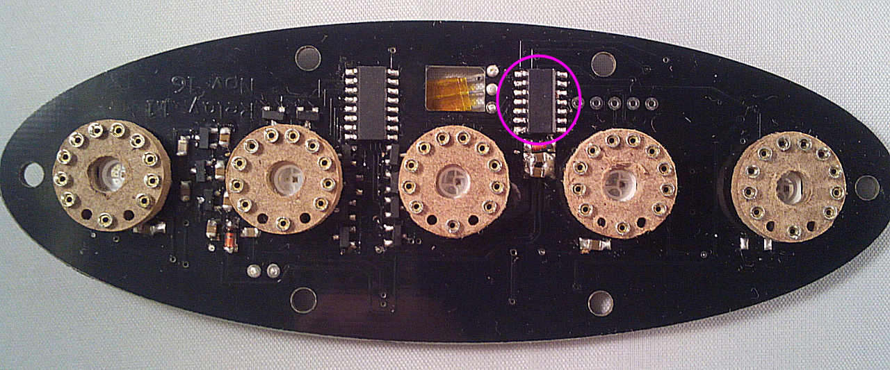

The last electronic component before the nixie sockets - the PIC. The pin 1 marker dot faces DOWN towards the zener diode this time.
